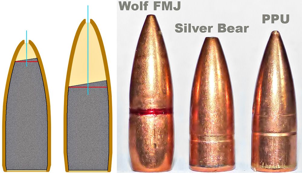

Makes me wonder about the balance of any bullet. Some of Hornady's .308 match bullets are as much as .0004" out of round on the bearing surface. Definitely not for precision, just an example, I was looking at some 7.62x39mm bullets. My SKS is not vary accurate at any time but some ammo shoots much worse than others. Notably the Wolf FMJ. (a pattern, not a group) I cut a few apart and was surprised to see the lead was not distributed equally producing a heavy side. All 3 of these are the same weight, so the longer one has a much larger cavity in the nose allowing the mass to be more off center and out of balance. Probably to some degree all bullets suffer from this, especially any HP design. How much does this alter the path of the bullet when it's spinning maybe 170,000 rpm?
