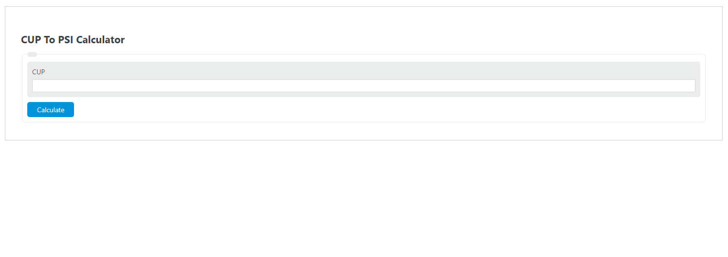

What does CUP represent ?
is CUP pressure measurement?
Copper units of pressure or CUP, and the related lead units of pressure or LUP, are terms applied to pressure measurements used in the field of internal ballistics for the estimation of chamber pressures in firearms.
CUP is a special unit of measure defined only for ballistic testing; psi is a standard unit of measure for all pressure testing in the English system. Whether you are testing radiator caps or valves for a nuclear submarine, psi is the same. CUP has no other use
Copper Units of Pressure
Basically a piston gets forced against a copper disk of know dimensions and firmness and you measure the permanent deformation made by the shot.
No known method of converting to something actually usable for comparison or mathematical manipulation - ie can not convert to PSI or any other standard unit.
