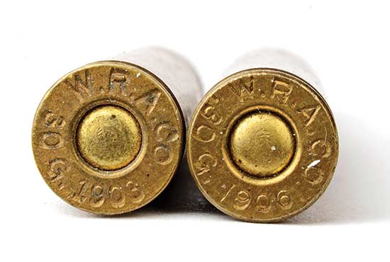

You have a potential first year 30.06 cartridge pictured, if there is a similar with a 1903 date, it would be pretty rare. The 30 caliber 1903, government is slightly shorter than the 30 caliber 1906, government.
Remington bought out Union Metalic Cartridge in 1912. So the UMC headstamp vs the Rem-UMC would help date some of those cases. WRA CO became WRA about 1930 and different cartridges changed headstamp over the next few years.
