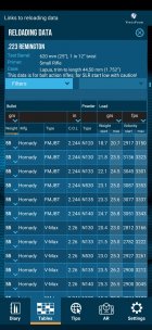

For those of you that are using a 55 gr bullet in a 223 with Vihtavuori powder, which powder is working the best for you?
The VV website lists several options of course, but I'm looking for personal experience.
I prefer to stick with the 100 series of single-base powders if I can.
I'm thinking of N130, N133, or N135.
The bullets will be either a 55 V-Max or a Sierra BTHP # 1390 varmint bullet. I have both available.
I have N140 already, I've found it works best with heavier bullets in the 75-80 grain weight range.

The rifle is a Tikka T3x Varmint, 24" barrel.
I've been using TAC with both bullets that I listed in my original post, with good results. I'd like to make the switch to VV, it's easier for me to get than anything else.
Speed isn't a critical factor, anything at 3000 fps or a bit faster will be fine.

I'm leaning toward trying the 55's with N133 and seeing what happens. It's interesting to see that the first line of VV's blurb on N133 is that it was designed for the 5.56 cartridge.
