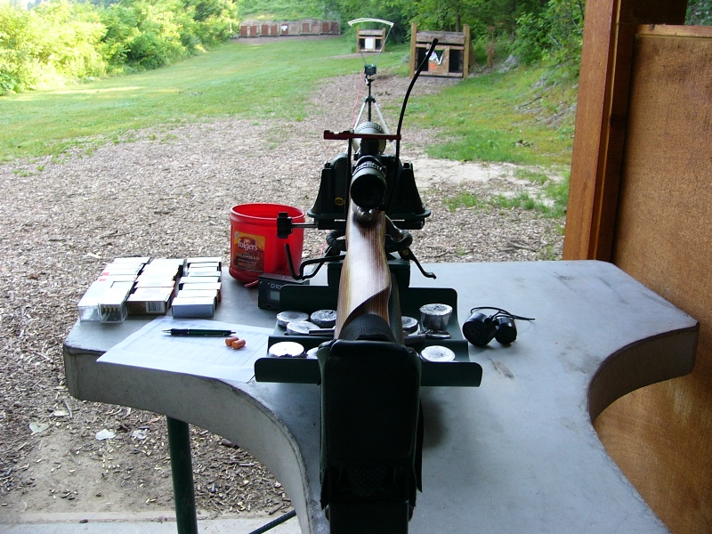

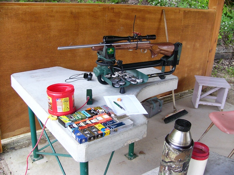

As I have said before, shooting from a vise or Lead Sled is as far from fun as you can get. I like to shoot my rifles, not operate a machine that does it for me. However, I wanted to test my rifle and the ammunition, not my shooting skills. There’ll be plenty of time for that later. So, I utilized my Dad’s Lead Sled with a Velcro strap that fit over the rear of the stock, to keep the setup as reproducible as possible after cleaning the bore.
Here’s a view of my lash-up:
Nothing professional to see there. Just making the best of what I had available.

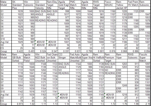

For those of you with a short attention span, here is a quick, ranked list of how they performed. The 10-shot, 50yard group size in inches, is at the end of each entry in <brackets>. The particular target associate with the group is at the front.
Updated 7/20/13
T5-4 SK Standard Plus <.422>
T6-1 Winchester Subsonic HP <.493>
T2-1 CCI Standard Velocity <.524>
T7-4 Eley Black Box Match <.526>
T4-2 Remington - Eley Target Rifle <.547>
T1-1 Aguila Golden Eagle Target <.591>
T4-1 PMC Match Rifle <.631>
T7-2 CCI MiniMag 40gr <.777>
T1-3 Aguila Match Rifle <.789>
T5-3 RWS Target Rifle <.801>
T3-3 Fiocchi MAXAC <.816>
T7-3 CCI MiniMag <.862>
T5-1 Remington Yellow Jacket HP <.868>
T2-4 Federal Premium HV Match <.886>
T4-3 Remington Subsonic <.894>
T7-1 Remington Govt Match <.940>
T6-3 Remington GB Bulk (Sorted) <.973>
T1-2 Aguila Match Pistol <1.02>
T6-2 Winchester M22 Bulk (Unsorted) <1.108>
T2-3 Federal Champion 40gr (Unsorted) <1.132>
T2-2 CCI Stinger HP <1.141>
T3-2 Federal AutoMatch Bulk (Unsorted) <1.142>
T1-4 Aguila SuperExtra Standard Velocity <1.444>
T8-1 Federal Champion 36gr (Unsorted) <1.472>
T6-4 Remington HV <1.497>
T3-1 Federal Premium Target <1.716>
T4-4 Remington Viper <1.76>
T5-2 RWS Subsonic HP <1.978>
T3-4 Fiocchi SuperMatch SM320 <2.156>
So, it looks like my rifle is a “cheap date”!
Here is a spreadsheet of their performance for those who enjoy a good spreadsheet:
