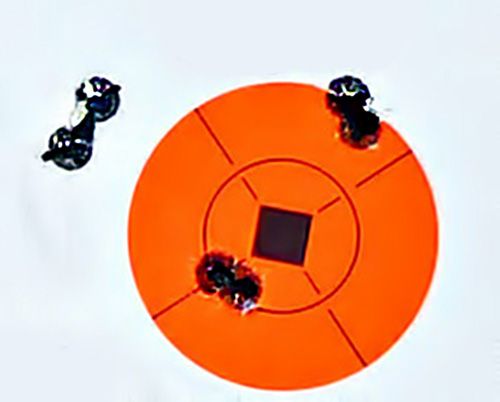

Here's my "cortina method" target
I don't like 3 round groups, I think 5 is minimum. Somehow I have the same thing happen as you, pairs of touching shots. Is that accuracy or random luck? Here is a strange one. This was 208 grain A-Max at 215 yards and I don't know in what order they hit. Even 6 shots here didn't tell me anything.

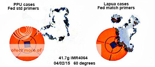

Here are a couple 10 shot groups from a couple years ago at 100 yards. Not the tightest but all in the same area. This was when I was using a beam scale instead of a digital and the powder loads probably weren't as close.
