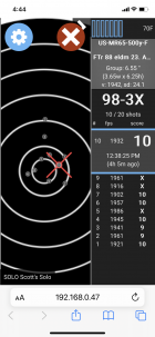

this is a good thread, thank you for starting it as I asked the same question of myself Sunday while testing at 500 yds. 223 Savage F TR rig 88ELDM Had two shots go way up on.
I will preface the photo, Mirage was very thick at the range and the terrain is flat so the target image in the optic even at 40x was dancing around like a blur so holding off and centering the dot was just a guess. I ll keep watching this topic. Need a F class coach here .)
Xero Velocity was 2793.1 fps
SD this test was higher at 12.1
Load has been more like SD of 5.
23.7 N135
Virgin Starline 223 brass forming
CCI 450
-.075 jump
Duplin front rest and a Protector rear rest.
Not sure which rear bag as all gear is second hand aquired.
100 load testing has produced ragged one hole groups and this to me (photo) is all on me behind the rifle trying to find a repeatable position.
I did find my self touching the left side of the stock opposite my firing hand (right handed) and I seemed to settle down on the remainder of the shots. Fired quickly trying to keep the condition in play.
