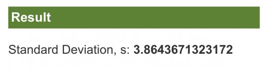

True. But even so, it’s nearly impossible to shoot 10 shots over any chrono device and get an ES of 8 and also still have an SD of 4. I’ve included a sample of 10 shots that would yield both an ES of 8 and an SD of 4, and the 10 shots are not very realistic or indicative of normal 10 shot strings.
I totally agree that that type of result is unusual, and questionable. It would take not only extreme care in the preparation of brass and assembly but a lot of luck. Doing so over 40 rounds and in 223? I don't use a Labradar so I don't know what issue might cause a error in reading velocity, but I would love to see the raw data.
