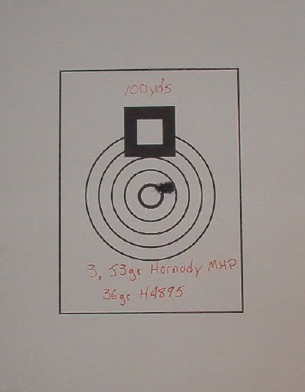

Same old same old here too. I tried like the dickens to get Varget to live up to it's reputation as a 22/250 propelent. Everyone told me it was the only way to go. OK results at best. Not bad mind you, just not what I look for in a 22/250. I keep coming back to H4895. I don't have any well thought out explanation for it. No printed stats to bear out my experiances. It just keeps working for me. Heck, back when the big O.S.H.A. thing was going on, I went out and stocked up on it. H380 is another powder I tried. I am kind of a ball powder nut. I love working with the stuff. Decent, but not super results. I guess the point to all this is, go with what your rifle likes. If things aren't quite what you expect from a varmint rig, try something else. That is the beauty of handloading.
This is my idea of varmint rifle accuracy. Being a woodchucker here in PA, 3 shot groups are just fine. Not near as fast paced as you lucky P-Dog poppers. The rifle used to cut this group was a Remington VSF 22/250. All this needed was moved up and over a trifle, and we were in business.
