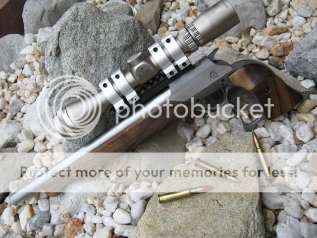

Here are a couple pics of my woodwork.
This set made from Burl Maple. The Barron Grip not to ever body's liking but it really feels good in the hand and very shootable.
This is a Get-A-Grip, good for absorbing recoil.
This set made from stabilized Black Fire Spalted Maple.
This is a one and only stock I made for a tender rifle.
MOA with a set I made from English Walnut.
