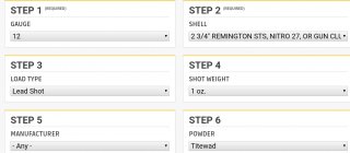

And yes, all of the load data I am considering is from the Hodgdon site. They have Titewad loads for 3/4 to 1 1/8 loads, but all of the buckshot loads are HS6.
FWIW the Lyman manual doesn't have a load/s for the TiteWad powder with buckshot and Remington hulls.
For that matter, no buckshot Titewad powder loads. More than likely too fast.
There are 3 loads with the same components, except amount of powder. Start with the 15.5 @ 7,900 PSI load & around 1oz of buck. 20201208_101935.jpg20201208_101850.jpg
