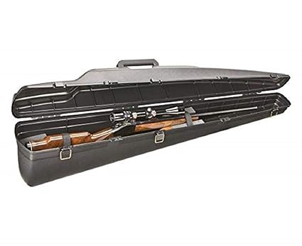

I normally transport my rifles in a top-loading Plano Airglide case which has a slight downward tilt, so I don't have foam coming out the rod guide. After the drive home, there may be a few drops at the muzzle end -- but not a big deal.
Airglide case (mfg. photo, not my rifle). Muzzle is lower than action. This case may not be long enough for rifles with barrels over 28"
