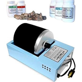

I dry tumbled Moly bullets for years, with mixed results. I now wet tumble moly bullets in a rotary tumbler. 100 / 500 bullets with moly powder, a little water and one drop of dish soap. 2 hours of tumbling, rinse off the bullets, dry them in the oven to boil the water out of the hollow points, and they look like jewelry. No polishing, perfect coating.
This tumbler
I put the bullets, copper plated lead BBs and HBN in a 4oz Nalgene bottle
It is about 4" high
Tumble for two hours, towel off the excess.
