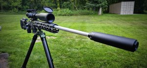

Just completed my build in a 223 AI
starting load development
Today

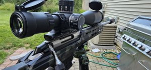

26 GR AA2230 with Hornady 62 GR ELDVT seated .020" off lands
Tikka T3X Action
Brad's Barrel 26" 1-7 Twist
KRG XEay with closed forend ARCA
Tikka Trigger lowered to 1.5
Discovery 5 x 25 Gen 2 Mil
Arken 20 MOA Base 34mm
Maxim Defense PRS Can 6.5

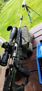

First shot was 3400 fps and gas in face
looked at primer ..small hole
2nd shot gas in face 3300 fps ..
Stopped at that point ...tore down remaining rounds and
started over at 24 gr AA2230 ...

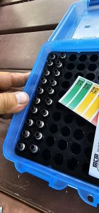

2nd string of 5 ...dropped to 3005 fps
SD 6
no signs of pressure ....grouped into a 1/2" group

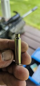

using fireformed brass
Lee Neck sizing die for 223
Lyman 223 seating die
I decided to try 25 gr ...had 3100 fps ...grouped for shit
and popped a primer ...
stepped back to 24 GR ...sweet spot ..

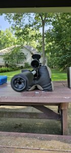

BTW I watched a few YT channels about these Discovery scopes ..the ED PRS GEN 2 5 x 25 x 56
FIR FFP -z in particular ...
I had to give it a shot at $332 after the code applied ...I received a ton of gear from them
the scope quality has me speechless.....it's every bit as good or better than the Arken EP 5x 25
I've had Loopy MK4 and IOR Valdada back in 90's and 2000's this scope
is better !
Glass is same or dare I say better ?
I have $2500 into this rifle complete and it's a dream to shoot ...
Once I map this load dope out , she's going into the field to harvest Yotes ...
Try one of these scopes ...I just ordered another today !

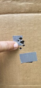

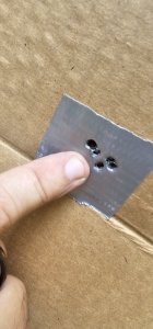

OK I wanted to create a lil handful of brass to work with today so it was fire forming
Nickel Plated mixed head stamp Speer and Federal ...(I'm a varmint hunter)
not a benchrest shooter ...lol .
Fed 205 M primer
AA2230 23 GR
Nosler 69 HPBT Match
shot like a gem !
first 5 shot group ....
Then finished the 15 into this lil group
That's my pinky !! not a finger ...the group is small
