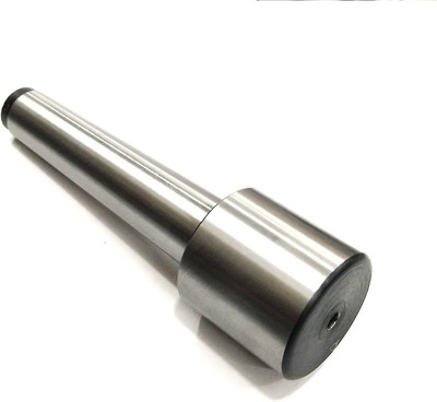

update: rigid reamer holder
I made a MT -2 taper for my tailstock for the floating reamer holder I made. I like it because it's not hand-held and allows for any alignment issues in all 3 axis.
Cuts concentric, on size chambers when I check them so that's everything I need.
