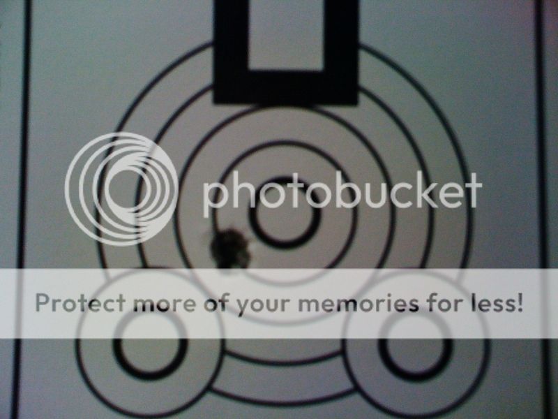

Anyway here are a few of the groups that got me quite a few small group patches,,,,
This group was shot on my sighter, reel shame as it was the smallest group that the rifle as ever shot???,

Wow! Thats a shooter. ;D

Very nice groups. Impressive
