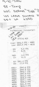

Chronograph update: 9-10-2006
Temp: 88
High: 3052.7 fps
Low: 3034.9
SD: 5.5 fps
CV:0.2%
Mad: 4.2 fps
Average Velocity: 3041.2 fps
ES:17.9 fps
-Jeff

Pact printout attached,
Update 9-10-2006
Temp: 88
Average velocity was 3046.9 fps
SD 5.6 fps
This is the 2nd loading of the new Norma/ Tubb brass. Primer pockets still tight.
