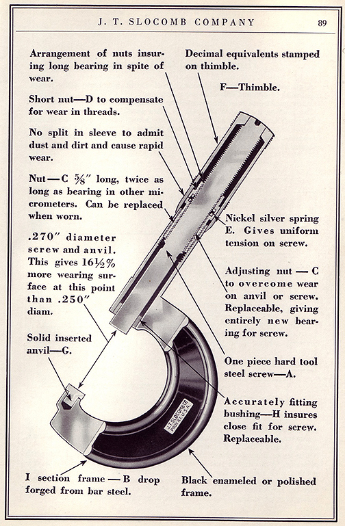

The micrometer is a J.T.Slocomb 1" mic. that my late dad lapped to exact zero. I read the tenth's on the mic. when appropiate.
I also measured the primers with his Brown & Sharpe mic. and got the same readings.
This mic. has also compared the diameters of the primers listed.

"You might want to check the calibration on whatever your are measuring with."
Note that I used the J.T Slocumb micrometer that my late dad lapped to zero for me!

Below is my micrometer that I bought in 1973 about the same time that J.T Slocumb went out of business because it did not modernize and keep up with the competition.

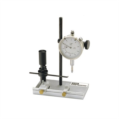

If you think your bent paper clip is more accurate than my RCBS Case Mastering Gauge then it just shows your reloading inexperience and lack of knowledge.
Below is a once fired factory loaded Winchester .303 British case, it has stretched .009 in the base web area and "YOUR" bent paper clip will not tell you this.
