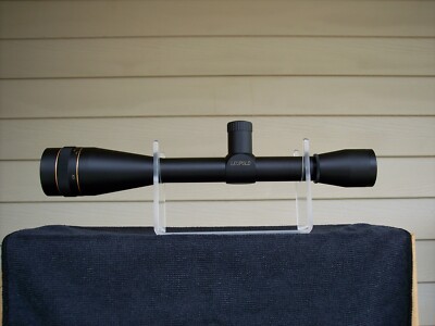

I recently purchased a Leupold 12x AO scope that has me baffled. Windage turret is conventional Leupold friction type, but the elevation turret is exactly the same as their target style scopes, tall turret, with 1/4" click adjustments. It isn't an aftermarket turret, such as Stoney Point.
Any info on this scope would be appreciated,

Most likely the turret was installed in the Leupold custom shop. They also made a Varmint model with just a target turret for elevation and a standard turret for windage . Great scope as I own several.

Premier also did turret swaps and power bumps.
Had them install Mark IV turrets and bump a 6.5-20 to 14.5-36 20+ years ago. It's still clicking along nicely....

True statement. I still have and use Leupold scopes modified by Premier Reticle. Two 12x as described by the OP, two 6.5x20's and one Silhouette Special as Premier called it. A 3x9 VXIII with windage and elevation turrets. that have been cranked up and down thousands of times over the years. All work perfectly.
I have sent many Leupold to the Custom shop and had target knobs and dot reticle added. I used to cost $60.00 to have a 1/8" dot added and $60.00 for target knob. So $120.00 if both were changed. Mark 4 target knob were $70.00 each. The Custom shop was the best part of Leupold.

I have the same scope, marketed as a silhouette scope, I believe. Coincidentally, I use it on my Model 52 M-S rifle. I don't believe there is a scope in their current lineup that I would buy. WH
