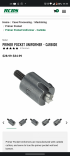

I used an RCBS non-adjustable carbide unit for years, since around 2004 or so. It got stuck in a piece of Hornady brass back in August. I put the uniformer in a vice and pulled the brass off with vice grips. As it turned out, the cutting blade fractured and came apart, causing it to get stuck in the case. I purchased a new non-adjustable unit from RCBS and it barely touches the primer pockets on the same lot of brass. It really makes me question how consistent the uniformers are from tool to tool. I mostly use Lapua or ADG brass, but tend to uniform Hornady, Winchester, Federal, etc.
If you got this one. It is adjustable. Loosen the grub screw, add mild heat to the black portion, the screw stem has a hex style where you can put a hex key and turn to remove the carbide insert as your putting heat and some pressure on the screw The carbide insert is glued with locktite. I then clean it, and then use the screw to adjust depth of cutter. Then tighten the grub screw.
