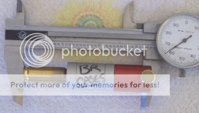

faster45432: I've been using the 'Hornady Lock-N-Load Headspace Gauge Tool', Sinclair catalog#2009-B, page 37, $36.75, Part#HK-66, for a lot of years now,,previously made by Stoney Point), and watch headspace length very closely. When having a new chamber cut, I'll take one of the first cases fired, hand punch out the primer, clean the case, and take the as fired, headspace length dimension for that chamber, recording that measurement, then adjusting the Redding FL bushing die sizer to no more than .002' shorter. Have never seen the impending case head seperation 'ring' as your excellent pics show, and one batch of 6BR Lapua has 28 loadings now, although the primer pockets are starting to get lose, so a few more loadings & they will get tossed. As mentioned, you may be setting the shoulders back just a little more than is req'd. I try to keep the cases sized so that there is a little resistance when closing the bolt: tells me the cartridge is 'snug' in the chamber, front to back, and with the tight, fitted neck, there just isn't anyplace for the brass to go.

A headspace tool like the Stoney Point mentioned or the Sinclair tool is the correct way to measure case length. Use a gauge when setting up your die and set the 'bump' at .001-.002.

Here's a couple of pics that show how to measure the shoulder 'bump' using the Stoney Point/Hornady tool.
This pic shows a fired case measurement. The primer needs to be removed so as not to influence the reading:
This pic shows the case with the shoulder 'bumped' back .002:

Setting the die by feel is a bad way to go.....it's possible for the die not to be sizing the shoulder/body junction enough,not uncommon with the BR cases). You can end up moving the shoulder back .010-.015 before it 'feels' like it should. And as much as I love Redding products, their Competition shellholders are not always what they are marked.

I have trimmed my cases to 1.500' and after approx 8 reloads, the average case length is 1.505 with a Standard Deviation of .002 Once I see the pictures of how to measure the case stretch and did more research, it now starts to become clear. Like the old adage, all things are clear once understood. Thanks to the great feedback from this forum it looks like my course of action is:
1. Internally inspect all cases for signs of impending failure
2. Purchase the Sinclair tool and make the exact measurements and eliminate guessing.
3. Use the appropriate shims or shell holders to adjust as needed.
