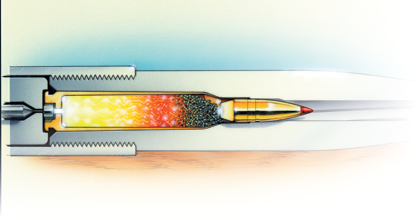

Not all powder is created equal. The primer does not ignite all of the powder at one time, it burns progressively from back to front. Once the pressure builds enough to overcome the friction of the bullet retained in the neck, the bullet moves down the barrel pushed by the burning gases called plasma.
This is a very short, animated explanation given by a very nice looking woman...
If that pressure builds faster prior to all of the powder getting ignited, the unburned powder rides on the pressure wave at the front of the super heated plasma. In some combinations, a small amount of the powder may never burn before leaving the muzzle of the rifle. We demonstrated this by putting old white sheets on the ground below and in front of a rifle (usually on a bench), firing one shot then examining the sheet carefully. Some inefficient load combinations eject quite a bit of unburned powder. An exaggerated example would be a very slow powder in a small capacity case such as Retumbo in your 6 Dasher.
