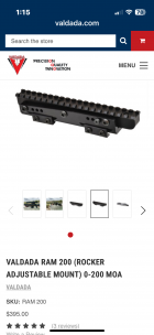

Here’s another option for more elevation and they’ve made big progress last decade with prisms
NF also makes them.
ELR and low useable elevation scopes make things difficult.
The action is a LB/RP/LE BAT M. The locking levers might interfere with the bolt or at least with my hand when I actuate the bolt.
My 338 Lapua improved with 285 ELDM at 3000fps needs roughly 68 minutes at 2K at 1000 ft elevation. I have a Field & Cave 50 MOA base that mounts to my 20 MOA rail. Perfect for an ELR set up out to around 2K. If I'm in 6000-8000 ft elevation in Wyoming, I can get additional range and it drops my necessary minutes to around 55 minutes of elevation. I like using my rifle for 500-1000 and I can do that with this 70 minute base.
Option B would be the Ivey system. I saw several of them at the Ko2M a few years back. They allow you to center the crosshairs and shoot out to the 2 miles at the range under competition conditions.
