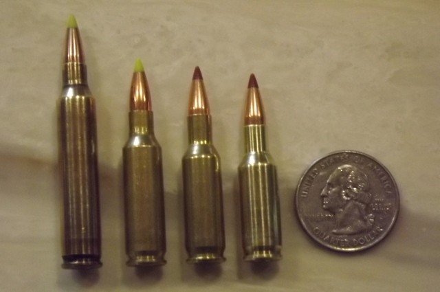

Hi Evan. Here are the pictures. I have included 3 others for comparison. Left to right, 204, 20 vartarg, 20 viper an the one that I am working on now, the 20 vt "short".
The rifle is a cz 527 that is my switch barrel for all 4
Fun projects. Dan

Those look great! What powder are you targeting with the 20 short? Seems like you may not get enough 4198 in there. Pistol powders?
RG

Your right Evan. I think h 4198 is out but it is my go to for 20 VT. The powders I plan on trying are cfe blk, A2200 and RL 7. I have tried LIL Gun in other small cartridges but it gets a little scary for me but it would probably work fine. My 20 viper which is only .093 longer than the “short” shoots a little over 4000 w 18.8 G cfe blk and the 24G ntx
