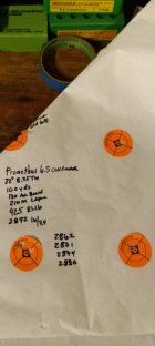

I've shot, some very "Good" groups with, Horn 123 and 130 grain, ELD-M's and, 143 ELD-X's, in a 1-8 Twist.
I'm going to "settle" on the SLIGHTLY lower, recoiling ( but, Higher BC than, 123's ) 130's for, Steel & Varmints and, the 143's for, Deer / Antelope. I will "Dial" Range for, Both loads with, MOA Turrets and, Charts using,..
a 200 Yard, Zero.
