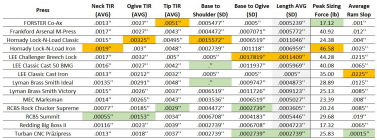

Any more information beyond the chart? I'd like to know how they measured to 7 digits after the decimal point.
Yes, Sir, please provide the whole chart and description.

One reason that I showed the chart was to show how the first column correlated with the last.
A few years ago, I suggested a modifications to shell holders that would it to float more, a friend with a lathe modified one, and also the top of his Rock Chucker's ram. We have also set the spring clip aside in favor of an O ring. I have also compared the results using Lee lock rings set so that they do not go metal to metal with the press, and I can tell you that each of these has some measurable effect on runout, but IMO there is a point beyond which I cannot see the difference on the target.
I have no idea what that means. Can you explain that process? I’m genuinely curious how the measuring process and the resulting calculations can reach out to 7 digits.
