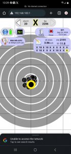

Things got better after .0025. I tested all the way to .005 with no loss of accuracy. I've since settled on .003 across the pressure ring of the largest bullets I use (.3088 & .3090). The necks seem to pick up about .0003 (total) after being fired 5-7 times. At that point, they settle down.
As a side note, at .004 I could start to see a bit more runout on the necks after sizing. At .005, the runout was definitely more. No change in the accuracy, though.
Good shootin' :) -Al
