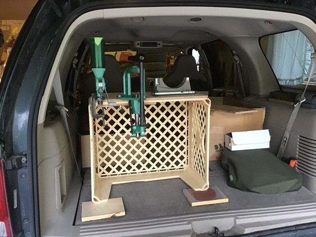

I was developing my 115-gr. cast lead 30-cal load yesterday because I got a new barrel. I do my seating at the range for that, so I can easily play with different seat depths and powder weights. I spent all day doing that.
The amazing thing to me was that with one particular powder-weight I was getting consistent 1 moa groups, but if I varied it even a 10th of a grain up or down I was back to 3 moa.
The seat depth I had worked out earlier, but who knows, maybe now that I have nailed the powder weight I could improve it even more by playing with the seat depth again.
I also have to wonder if I don't need to start setting my beam scale to my (apparently) optimum setting, but then trickling until I am, say, ONE-THIRD of the way between the "zero" line and the next line up! :) And then 75% of the way to the next line, etc.
It's funny how many guys walk by and think I'm nuts for "loading at the range," but I think I'd have to be nuts not to.
