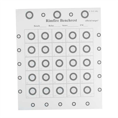

Rba Rimfire Targets 25 Pack US Specs & Supply
I do load development on these. They are thick and strong and I mount them on cardboard. I take a straight edge and go through the bulls in both directions making a very precise point of aim. This is a very good set-up for reading groups and single-hole shapes. They are called RBA Rimfire Targets........This thread has some great input......
Regards
Rick
