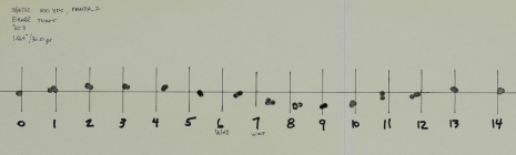

That said, I'll post a tuner test target here. It shows you everything you need to use my tuner but it's important to do it exactly like this test target, no exceptions at all!
Right down to making your own target just like it.
It's all about group shapes. Virtually every single gun will print predictable group shapes from dotting up and for the next couple of marks. It'll go from dotting up, to straight vertical, to diagonal group up and to the right. When you see that succession at top or bottom of the sine wave when done, there ya have it. The group shapes and their position at near top or bottom validate one another to confirm your setting. The test tells you which way to go when you see those respective shapes later, too.
The test is solid freaking gold!!
Here's an example of the results sent to me before I made up that target(above)and took a pic of it for instruction purposes.
See the group shapes I described?
10,11 and 12 are textbook clear! In this example, I'd go back and shoot around the 2 setting as well, just to verify but 10 is a safe bet.
As for a range or rule of thumb...I don't get caught up in that much. Using a tuner is just like tuning with powder charge. Yes, there are days you'll have a pretty good idea that you'll need to come in or out a mark before you ever fire the gun, just like loading with powder! You'll know before you ever shoot that you'll need to go up or down on the charge before you even sit down..within reason. But I don't suggest getting married to setting the tuner by what you "think" before shooting, unless you have to for some reason. That's when good notes help more than anything.
This is not a one off fluke. I've literally seen well over a thousand of these test targets sent to me by other shooters and the same pattern is virtually always there. It's not random or coincidence.
See why I constantly tell people to move in tiny increments?
