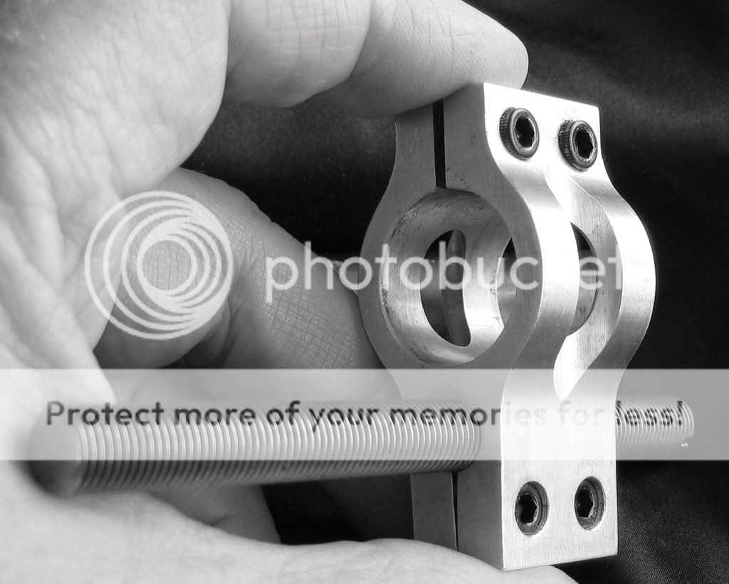

Some years ago, Dwight Scott built a few tuners that clamped to the muzzle and were adjusted by moving a threaded rod that was held below the barrel. Actually, you could clamp it so that the rod was clocked anywhere you wanted it. I have a couple of copies that a friend made from my reverse engineering of a photo from Precision Shooting magazine. I also have a couple of other designs that thread onto the barrel and are symmetrical to it. At the time that I played with all of them, my level of sophistication as to how to adjust them was pretty low, so I would not be able to give you an up to date evaluation of their potential, except to say that the ones that thread onto the barrel have done well for others.
