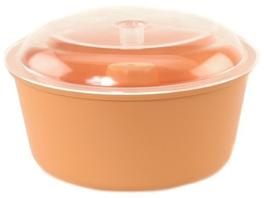

I use a vibratory tumbler with these bowls from Lyman.
Nothing but bullets and powder in the bowl. I can do about 1000 6mm bullets at a time and about 600 or so 30 cal bullets.
I wash bullets in acetone or lacquer thinner and dry thoroughly. I like let them dry outside on a warm, sunny day but it can be done in the oven at low temp. You want the bullets warm enough that they are uncomfortable to hold in your hands. Put them in the tumbler warm and add powder. It doesn't take much. Maybe a thimble full for 1000 bullets. It will take a little more to coat the bowl when new.
Let them run for 3-4 hours and dump them out on an old towel to buff off the excess. Done.
It does work better if you don't overload the bowl. They move around and coat better/faster.
That's all I can think of. Nothing to it. There are different methods that work but this is what I've found to work best. The warm bullets hold heat well and dry the powder while they run. It does much better this way as opposed to the powder being moist from humidity. Some claim it opens the pores of the copper jacket. That may be true but I think it's mainly due to the powder drying out. It just does a more even, prettier job IME.

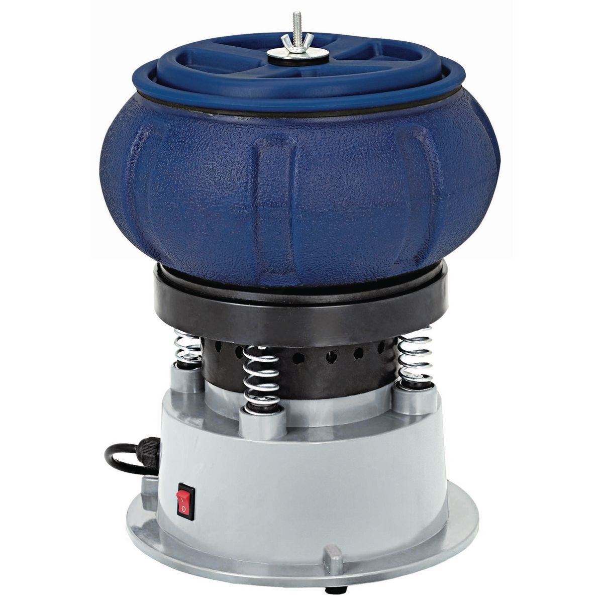

5 Lb. Metal Vibratory Tumbler Bowl
CENTRAL MACHINERY
5 Lb. Metal Vibratory Tumbler Bowl​
Probably works just fine. Mine is a 20 year old RCBS tumbler but it still works fine too. I'm not sure how they "weight rate" them but I can assure you, it has more than 5lbs in it when full of bullets...maybe double or so before it acts like its a little over full, weight wise.
You'll notice the bullets begin to "flow" more when they just start coating vs bare and cleaned....fwiw
