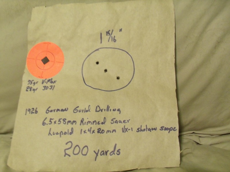

Here are some groups fired with pretty marginal guns with low power scopes

Leupold 1-4x20mm at 200 yards 6.5x58R Sauer Wilkes drilling (1926)
It still gets the job done after 90+ years.

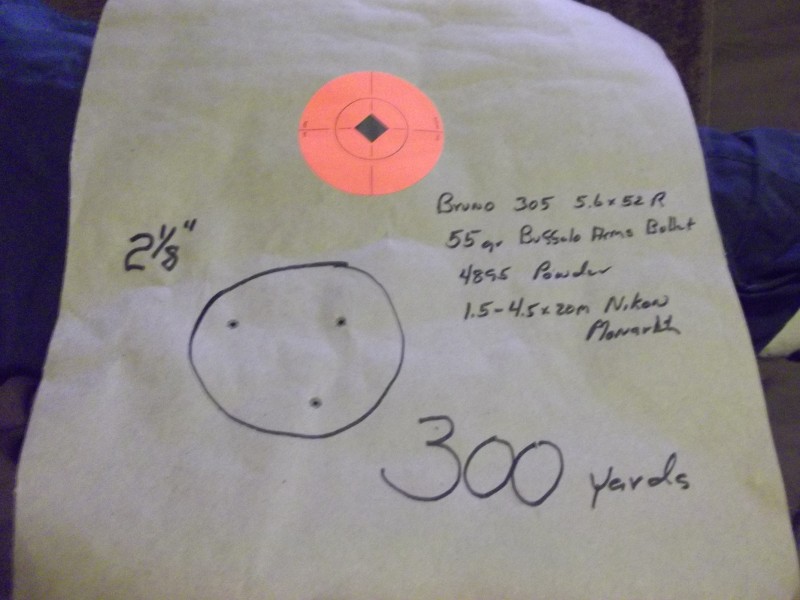

Nikon Monarch 1.5-4.5x20mm BRNO combo 22 Savage High power(5.6x52R) 1960's built at 300 yards.
Nearly 60 years old and still killing critters
With the low power scopes on the weapons even flushing pheasants ducks and grouse are in mortal danger. What more can you ask of a scope from your shoelaces to 300 yards your covered. Fast acquisition and pretty dam good accuracy. I've never felt under scoped with a 1-4 or 1.5-6 scope but I have been over scope on more than one occasion with higher powered scopes.
