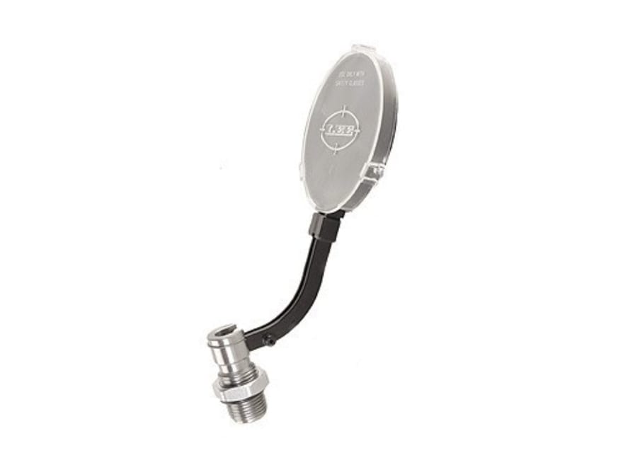

If you can find a used Lee ACP press. They were discontinued. They are not rim thickness dependent. Very easy to set your primer depth to whatever you want . New they were only about $100.
I bought the APP, works the same way, but didnt do well with feeding. I modified the bottom piece to accept the hornady micrometer bullet seater, and could get very accurate seating depth with it. the lyman is just so much easier to use and just as accurate.
