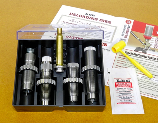

don't the Lee Pacesetter dies also operate similar to a small sizing die?
