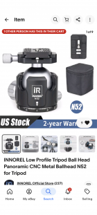

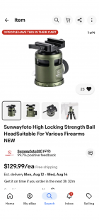

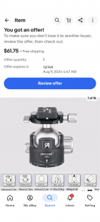

I've narrowed my tripod ball head choices to the following:
$130 Sunwayfoto 52mm
$ 89 Innorel N52 52mm
$ 61. Artcise TB54 54mm
Other than price, the only difference appears to be the Sunway comes with an additional picatinny rail attachment option and a lever release.
If you have experience with these or other tripod ball heads please give me any advise you think will be helpful or pitfalls to avoid.

The Artcise is what came in my kit from Little Crow gunworks. I have been very happy with it on my death grip tripod, using both the factory grip and arca plate. Not sure how a ball mount would hold up to dirt/dust and weather exposure. Work in progress, need just ears and a thin pad for the rear. The Outers varminter rest steady on a bench top. We can setup portable bench/Outers/rifle in less than 5 minutes out of pickup bed. Rinse off The Outers when trip is over IMG_20240808_102833839.jpg
Of the three you have listed i have the innoral 52.
It is a solid ball head
features i like
holds 66lbs
the ball head can go from level to straight down
the declination is 90 degrees useful in determining wind direction
irritant the friction wheel needs a full turn to tighten. I do not see a way to set the min tension tighter
The sunwayfoto you listed has a closed ring encompassing the ballhead it doesn't appear to have the ability to tilt as well as the other two. YT video show the presenter consistently bumping the arca plate.
do you do allot of high angle shots it might be a consideration.
The Artcise is close to the Innoral
The are the size of a beer can and weigh are around 2lbs
Cheers

The best out there are the Really Right Stuff (RRS) heads. The throw lever makes adjustments super easy. I also like that it will accept a pic rail or ARCA.
I also have an Innorel that I used to swap my Bog Pod Deathgrip to a ball head. It is good, but not nearly as easy to use as the RRS.
The Sunwayfoto is ok, but that locking knob for the ball head is junk. It needs to be much more tactile and not have rubber on it at all.
As much as I like those, the angle limitations are pretty restrictive.
