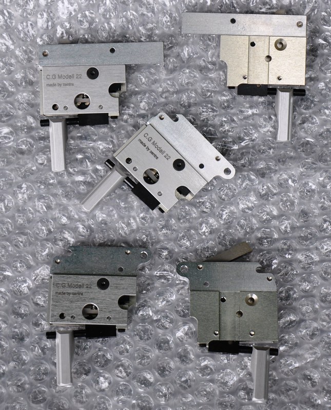

The original CG was updated by X-treme Shooting Products, now known as the Model 22. I have one, and it's a beautiful piece of workmanship. The sideplate is removable so that you can easily see how the various adjustments change the alignment of the 4 levers. By far the BEST feature is if you takeup the 1st stage and then decide not to shoot. When you release the 1st stage the sear returns to a deeper, safer engagement. I don't believe any other 2-stage does this.

I am not sure if Accurate Shooter forum members know the CG Model 22 is now being manufactured here in Europe and we are fitting the Model 22 trigger as standard to all of the Actionclear UK/Shooting SHED built CG Model 59 Actions and CG Model 66 rifle chassis systems. They are available with and without safety and with both the light or heavy spring options.
The triggers are manufactured by Centra of Germany
