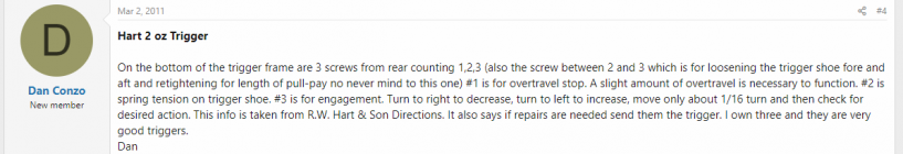

Pulled the S.S. below from another forum as I couldn't remember or find anything here. The link below is to a Hart trigger that sold recently with photos on this forum for accuracy.

After blowing the photo up, I believe I see the holes. Also, if it needs sear engagement adjustment it is the front screw. CW decreases engagement and CCW increases engagement. Adjust in 1/8 turns until it cocks correctly and passes a bump test.
