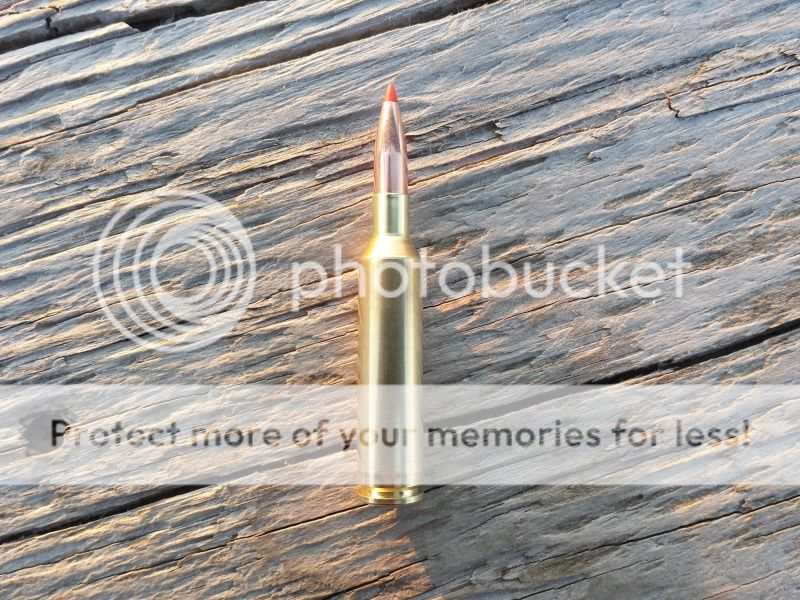

The parent case is a 6.5x55 Swed trimmed .035". The shoulder is bumped back to produce a .400" neck. After fire forming, the case has a 58.2 H2O capacity, in a short action.
Sorry my phone won't edit too good. The shoulder is a 30 degree angle. Our range is planning to add a1500 and 1760 yard berm. This cartridge will reach a mile and stay supersonic.

The basic premise followed along the lines of a short fat efficient case and a long neck, a 'la 6mm Dasher.
So giving up capacity due to the long neck and shorter case, I blew out the body with a slight taper of .015".
So far I'm pleased with the early results even with the thething issues.
