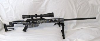

Here's a picture of my .308 with 30" barrel. I'm not a competitor either, but I am slowly working my way towards that. Since most of the competitions are held on Sundays, I may have to play hooky from church once in a while, but to me it's not about the competition, it's about being the best shooter I can be.
