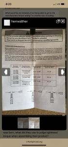

Found this, use at your own risk:
Nightforce Torque Specifications
• Base and Direct Mount™ attachment screws - 25 inch pounds
• Ring top screws - 25 inch pounds
• Ring crossbolt nut - 68 inch pounds
• Ring crossbolt nut for six-screw 34mm rings - 100 inch pounds
• Unimount™, Extended Unimount™ and MagMount™
• Refer to recommended specifications on Nightforce accessory packaging
