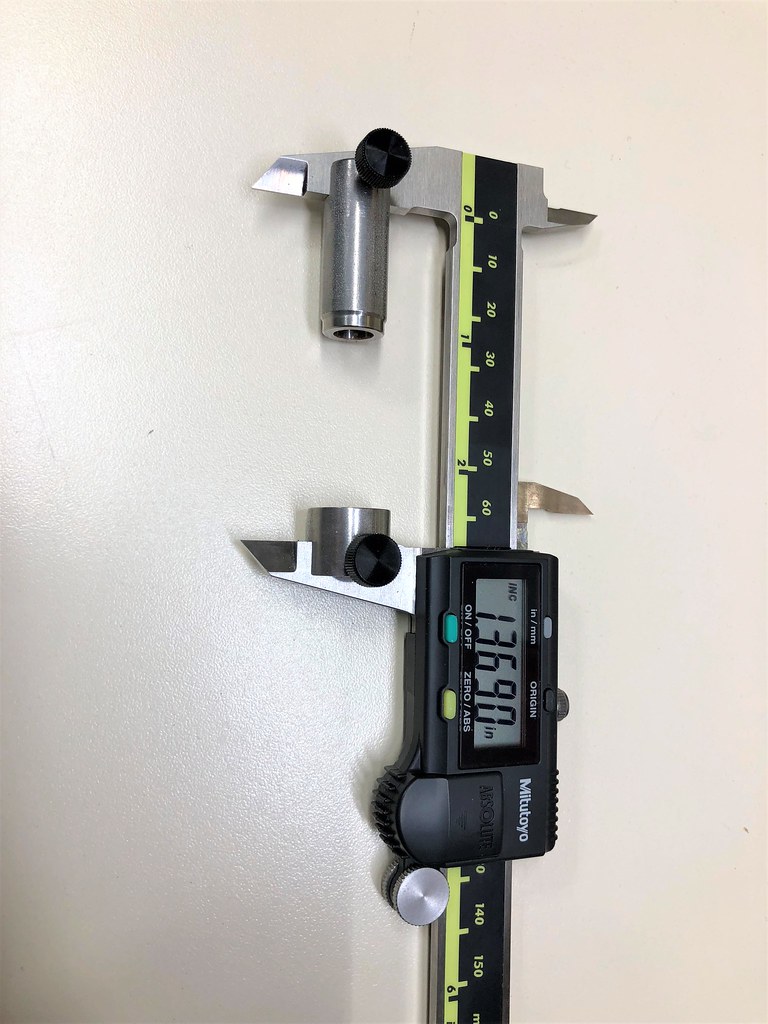

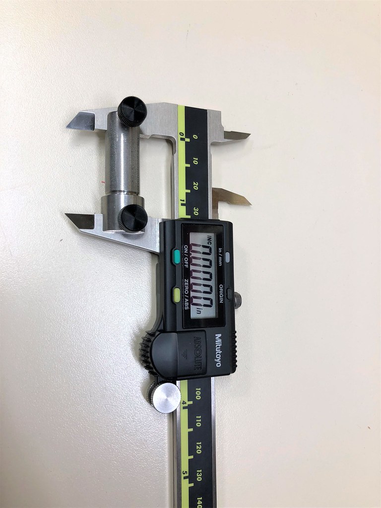

am I missing something ? what does the Davidson tool do that the Hornady tool doesn't ?
The Hornady and Sinclair adapters have 4 interfacing surfaces between the caliper and bullet. The Davidson has only two thus fewer opportunities for precision and tolerance errors.

I like the idea of the Davidson one but I've already made mine about ten years ago then I got the hornady unit to go with mine.
I thought about making steel bushings but haven't neaded to yet.
Edit I'm sorry I think I ment the benchrite
