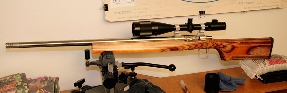

Does the slanting--that is, NOT parallel with the bore line--bottom of the buttstock make this rifle more difficult to keep on the correct elevation while using a rest at the rear (under the buttstock)? I shot a Shehane BR rifle with a Shehane Tracker II stock...
...in 2006-7. This buttstock's bottom was 'straight', which meant that when the rifle slid to the rear under recoil and then was simply pushed forward to the front rest's stop-pin, the elevation was unchanged and still, presumably at least, correct. The 30"-barrel Model 12 F Class's buttstock looks much like that of the Tracker II, but the BR's 29" barrel is already an inch or two longer than I think I want.
Short answer...No. Any benefit of a parallel stock would only matter during the first approximately 1/16" or less, of gun travel due to recoil. I see no benefit or detraction due it while pushing the gun back up, as long as a forearm stop is used. Both will simply go back where they were, or very close...parallel or not. A good rest/bag setup is what will dictate how well either will return. But, what shooting discipline do you plan to shoot with it. Rules may make it a moot point.

Just bought a bench rest laminated stock for my Savage Mdl 12 308. The butt stock bottom is flat (parallel to the 3" for end). When I am finished glass bedding the new stock I will be able to compare how both stocks work for me.
