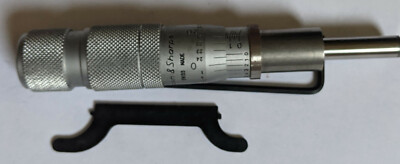

It's a nice project for the guy just getting started and makes life much easier for us old dogs. It doesn't have to be a direct tenth reading thimble like I used. A standard thimble like the one below works just as well.
