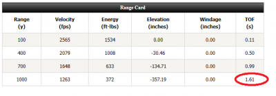

This question I’m ask a lot by none shooters. How long does it take a 6 mm 107 Sierra bullet to reach the target at IK . Average Muzzle velocity 2710, at 1k target average speed 1285 what’s your estimated time? Yes I know a lot of things come in to play just looking for a ball park figure based on the information given.
Approx 1 second
Edit: I just looked it up on my App,
1.60 seconds for the parameters you have given
It is more like 1 second for the 6x284 I use
Thanks guys, I normally just tell them form 1 and half to two seconds, I told one guy if I shot when my heart beat it would be there before it beat again lol.
