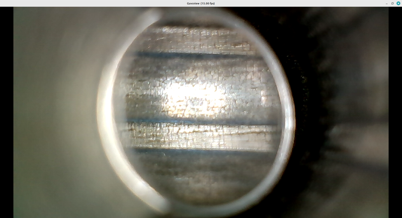

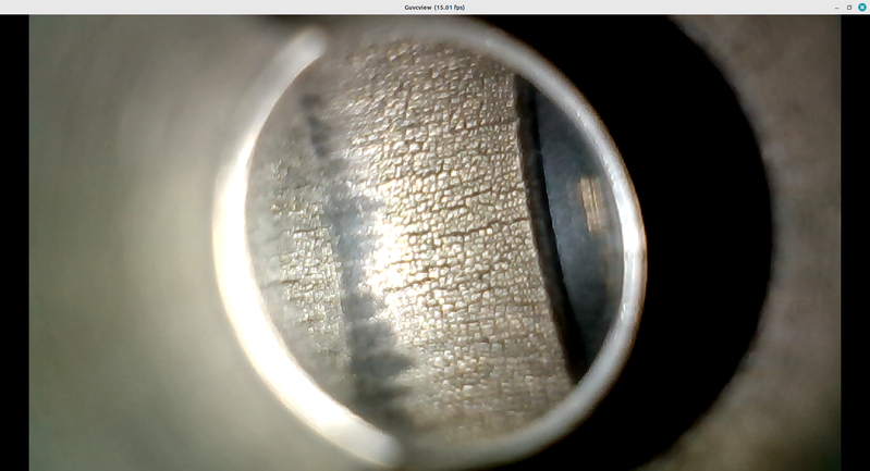

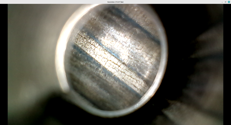

Time for a new barrel? This is a Rem factory chromoly .243 Win barrel. Round count is uknown. It still shoots 3/4-1MOA.
If 3/4-1 moa is satisfactory to you then keep shooting it. If you want better accuracy then get an ABC, Krieger, Lilja, etc. and have a good smith chamber and fit new barrel in whatever short action caliber you may want that shares a .473” bolt head. With a new barrel you can get the twist rate you want for the bullets you want to shoot. I suspect that factory .243 has too slow of twist rate for the 103gr and up long range boat tail bullets if you want to use the rifle for long range.

Needs cleaned ie Iosso'd for sure. After that does it still perform to satisfy you. Don't worry to much by what you see once it's cleaned. I have an idea you also have a carbon ring. A name gunsmith once told me not to fuss about the first 10 inches of the barrel the accuracy comes from the last 10 inches. I agree. I believe far more barrels with competitive accuracy left in them are discarded than absolutely shot out.
It sure looks like it is time, that's a lot of fire cracking. But if it still shoots as good as you need, start looking and enjoy it till it breathes its last breath. When it quits it will be obvious its done. This will give you some time to hunt a solution. If you have been happy with the factory barrel accuracy, maybe hunt for a take off. I had a friend that used to post here that would set up head space by varying the thickness of the recoil lug on Remington guns. I bought 2 300RUM noddle barrels and got several different thickness lugs from PGT and found one that worked perfect with my headspace gages.

What you are seeing is called fire cracking. Very common in competition barrels where strings of fire of 20+ get the barrel very hot. I've seen barrels used in varmint hunting with similar fire cracking. Heat a cool cycles cause this. Every barrel will end up with it over time. Not a problem in most cases. I had one barrel that was fire cracked a third of the way toward the muzzle and it still shot 3/4 MOA. I replaced it because it was not accurate enough for competition. That "shot out" barrel would probably have lasted the average hunter a life time and they would be delighted with the accuracy it provided if I'd moved it to a hunting gun.
P.S. That's pretty clean for a fire cracked barrel. Just shoot it.
