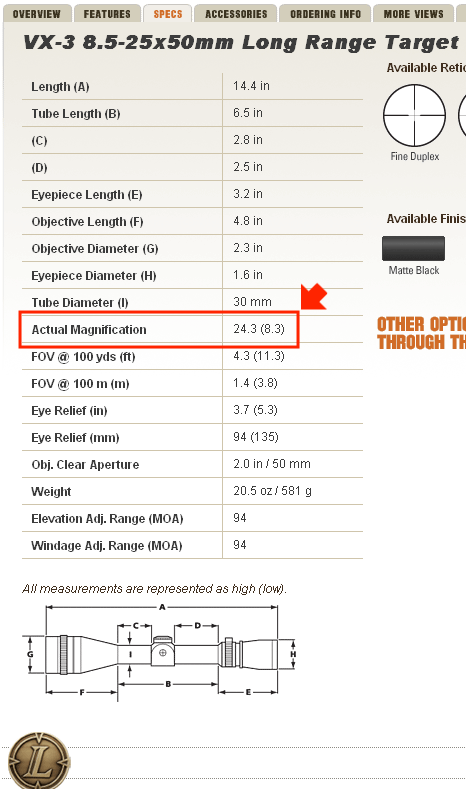

I have a Leupold 8-25 LRT and a Sightron 8-32. The Sightron is a much better scope for 600 yards. If you check the specs on the Leupold website, you'll find that the max magnification of the 8-25 LRT is actually 24.3 power. And, I have found that the scope starts to darken around the edges with the power ring set at 25 (which is really 24.3), so I back it off a tad. This means my usable max magnification is only 23X or so.
