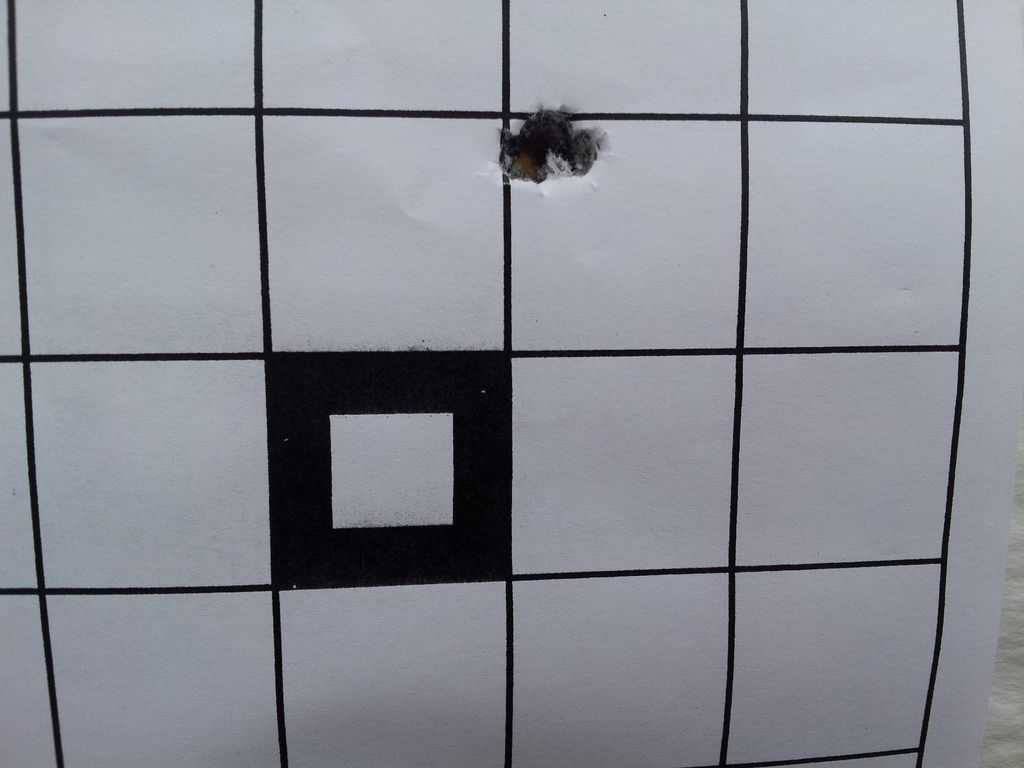

This is 5 shots out of my T-3 Lite (100 yds), it has had nothing done to it except for having the trigger adjusted to a lighter pull. The square is one inch, I did not even bother measuring the group but it is obviously a lot less than 1/2 inch. This not a cherry-picked target, it shoots groups like this on demand.
drover
