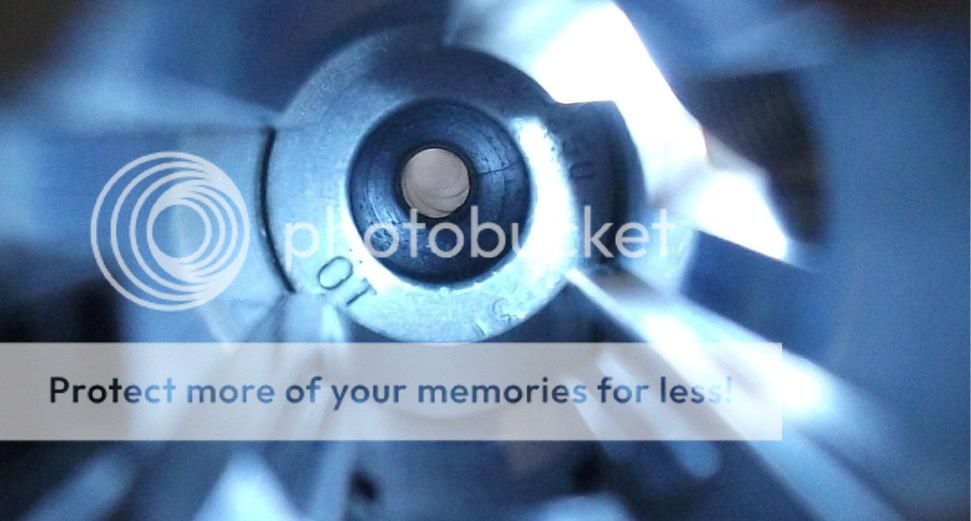

Hi i bought this new last week and when firing it was making a strange bang when firing after three shots, it fired thirty seven factory bullet shots over three outings twenty sako nosler bt and seventeen hornady v max .It was sent back to gunmark today .I had a picture taken of the bore and it looks like there is a crack also looks a bit rough .The bullets when ejected looked like i was getting gases coming back the way they were covered in a grey like looking mist.Any ideas guys
Well looks like a crack in the picture to me too. Wow...wonder how that could even happen if it is
a crack in the chamber! The cases also seem to tell a story too with gray mist....(burnt powder)
all over them. I think good idea to have it sent back or at least checked out. A bore scope could
tell more I think. Let us know what ya find. ;)

Gmk telling me my new stalon moderator w110 has a groove right up the baffles where the bullet is hitting them.They havent test fired the rifle yet ,dont know if this would cause the bullet cases to go grey with back pressure.They haven't seen this before

I only asked the question to see what people on here thought about the picture ,gmk are saying its a scratch but haven't fired the rifle yet due to adverse weather here, they still reckon the knackered baffles in the moderator are causing it to blow back but im not too sure about that .They are going to fire it today so will keep you updated on what they say

I hope they've rented a Bomb disposal suit :eek::eek: .............. Firing with & without the Moderator will show that the case is initially sealing/expanding the neck in the chamber. As pressure is relieved back pressure from the faulty Moderator allows a reverse flow of gases around the neck and shoulder of the case causing the smut on neck and shoulder. The gases continue on to the rear and exit the receiver vent holes. That's my GUESS. I'm sure they'll remove the Moderator before firing and find a spent case that has sealed properly and no signs of smut................ Seriously doubt there's a crack in the chamber. It may need a little polishing to get it back in "spec."

Your spot on gotcha this is the reply i got today .According to gmk its not a crack they have smoothed it off , the stalon w110 moderator was knackered, the baffles being struck by a bullet / bullets, it was brand new out the box. It hadn't been moving ,the baffles must have been out of line ever so slightly .The grey mist they reckon was the **** from the silencer getting blown back the way into the barrel from the moderator as the baffles were mangled.It arrives back with me next week ill try it again with the new mod they supplied
Happy to hear your problem is resolved ;).................... Hopefully they have redone /smoothed the chamber in a professional manner so the chamber isn't overly large in diameter and cause your sizing die to be working over time and/or work hardening your brass. Judging by the clumsy job of chambering I would ask that the barrel be re-chambered by a competent Smith. Good luck & good shooting !!!!
It was looked at by gmk gunsmiths and they said it was a very very fine polish it had , i had asked them the question regarding the chamber size and that is what i was told .My friend has a bore scope so ill have a wee look at it on Monday before firing again

I'd always assume the barrel threading for the mod was eccentric before thinking the mod body/baffles were misaligned.
How was the barrel threaded, ie alignment/mounting method?
