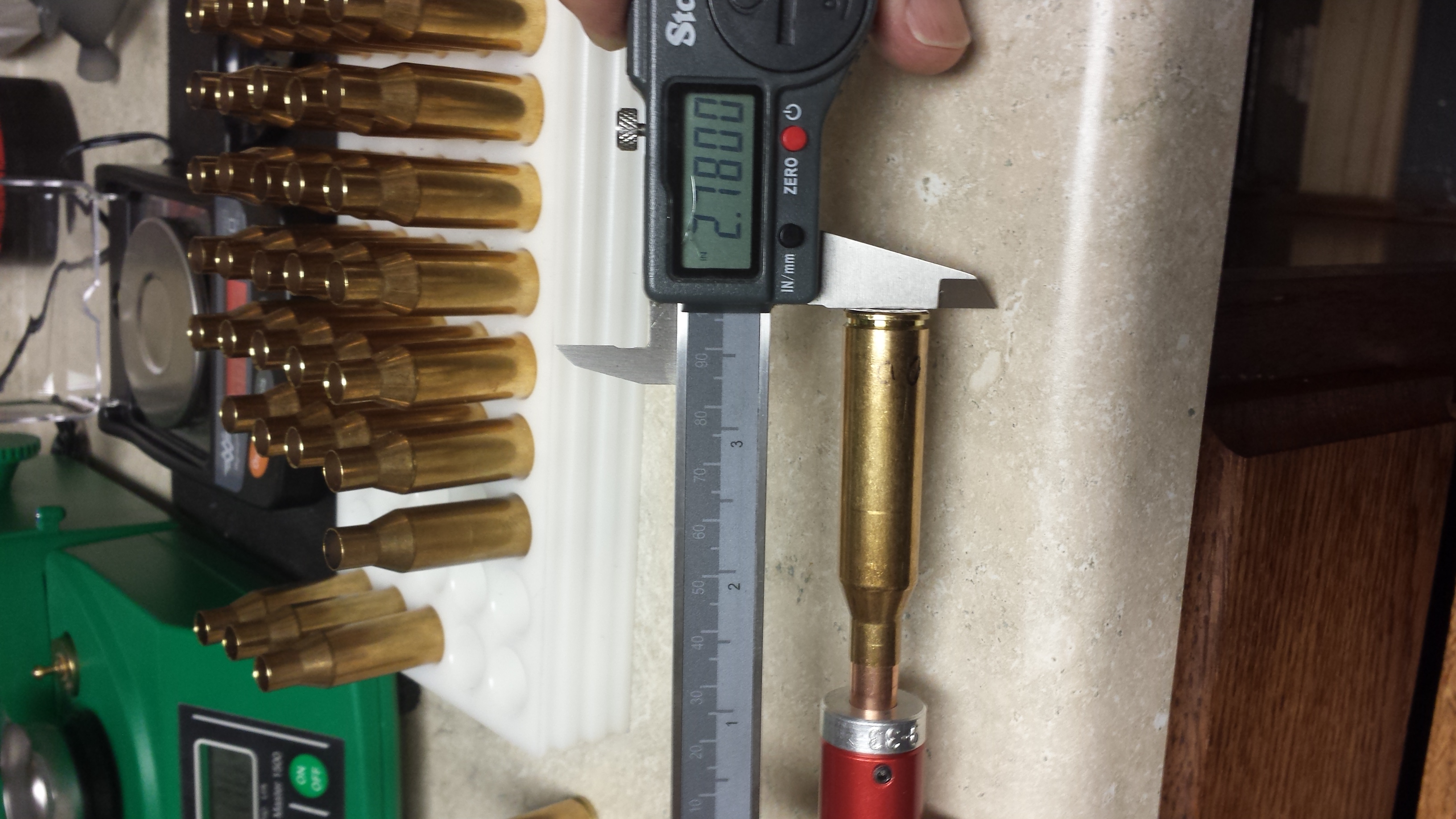

We have pictures! First is a side by side shot of the Lapua (left) and the Berger (right). The Lapua binds up and took considerable force to close the bolt. The Berger slides right in and the bolt closes like greased butter. See the scratches/marks around the ogive and shank on the Lapua?

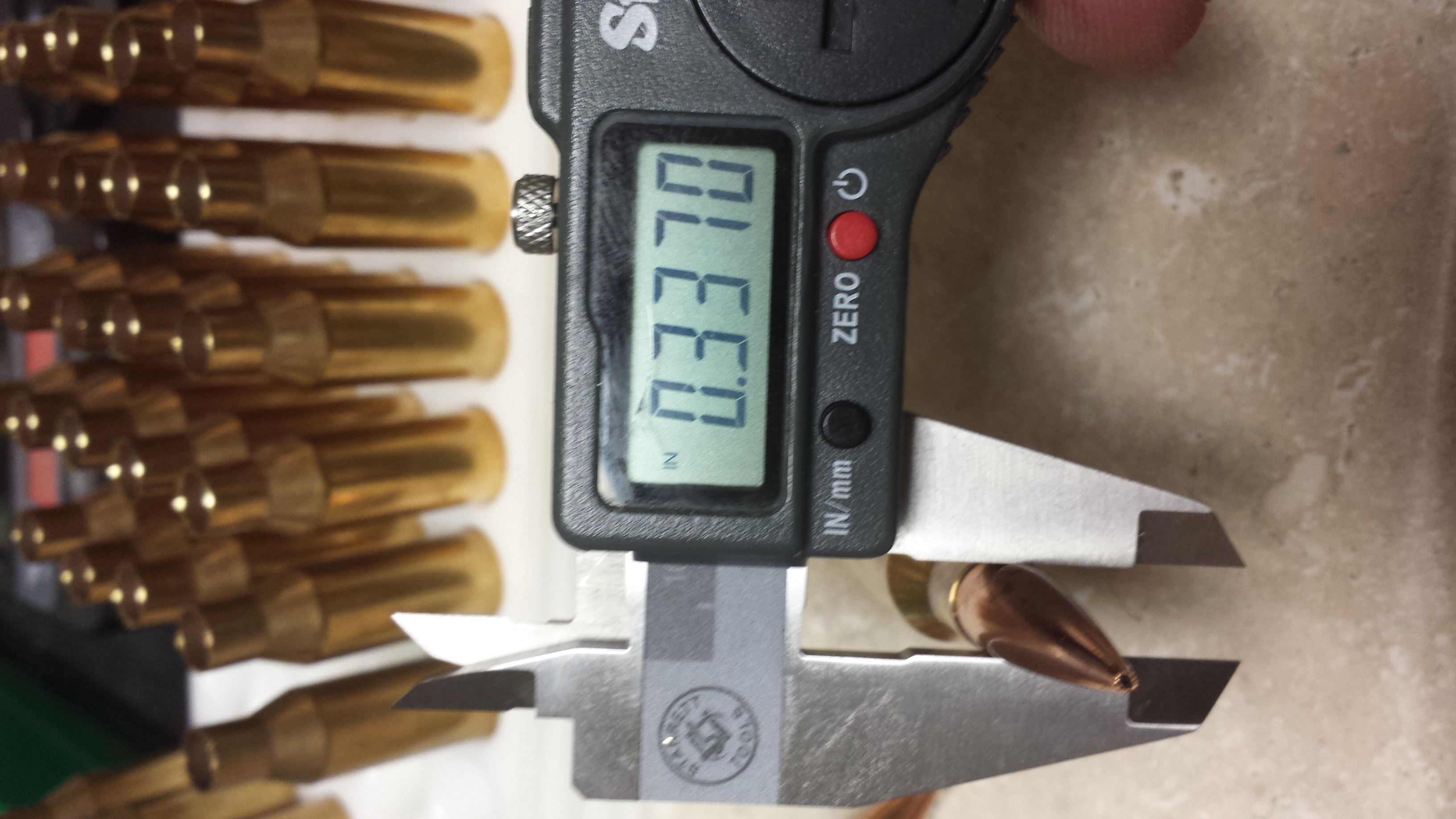

Next are the shank diameter measurements Lapua .3375, Berger .3370. Only .0005 difference....but.
Now pics of the case length. Note the Lapua is .0055 longer but do not believe that's an issue.

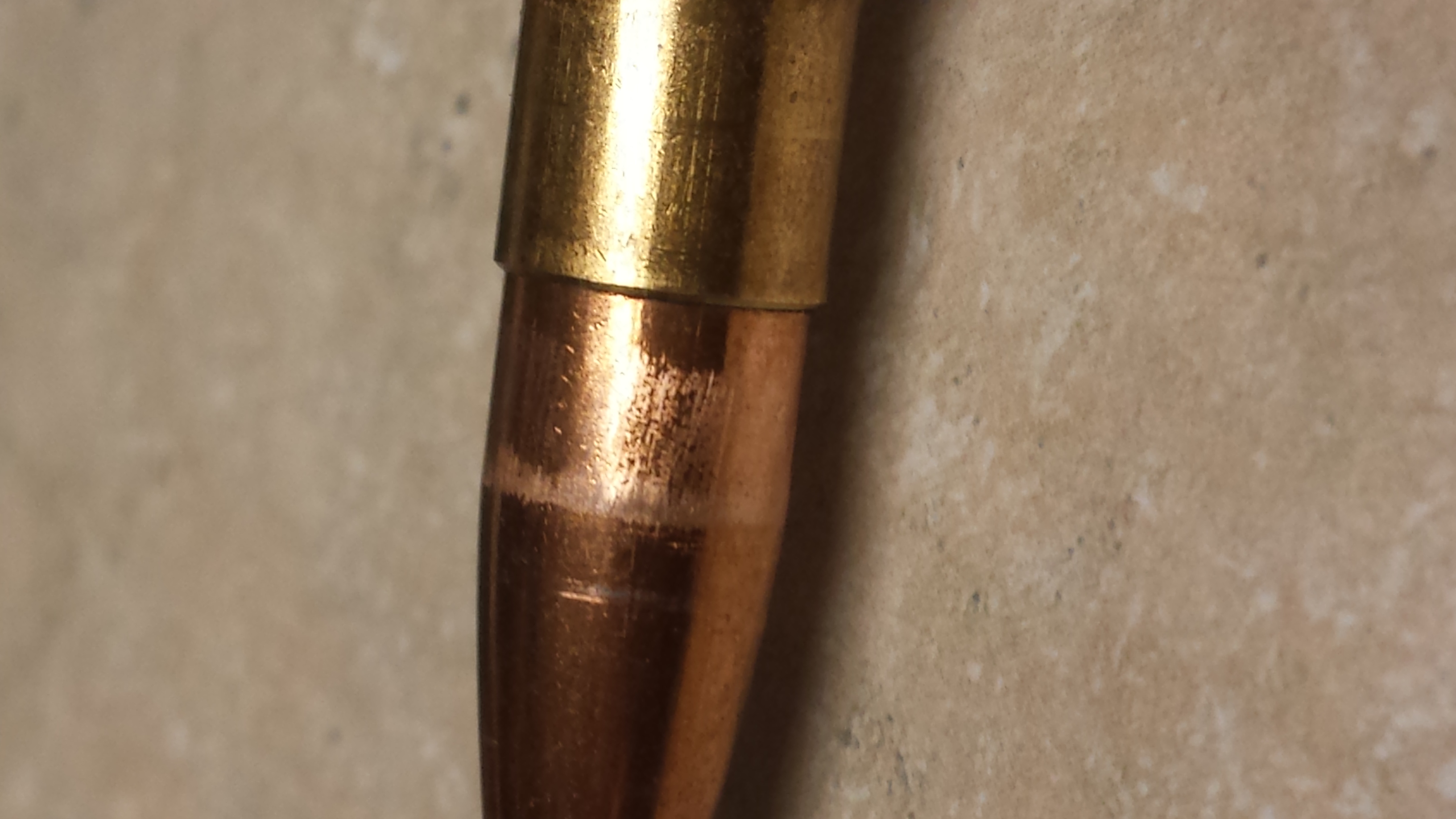

AND last a close up of the Lapua
mtang,
I'm not saying it is but in your 2 pics that show the marks on the bullets; best I can tell, there appears to be land engraving marks. Is your barrel possibly a 5 or 6 groove? As that would be consistent with the spacing of what I see as possible land marks. If they sure enough are not land marks, then you may very well have a tight throat and I expect you've got some hard carbon in there as well. I guess a chamber casting could give you an idea of the freebore diameter.

VH/, You are correct it is a 6 groove. I can't see the markings you are seeing, but my eyes are not what they used to be. It looks like solid contact all the way around to me.
Thanks for the input. If I can get pics with a borescope soon I will post them.
